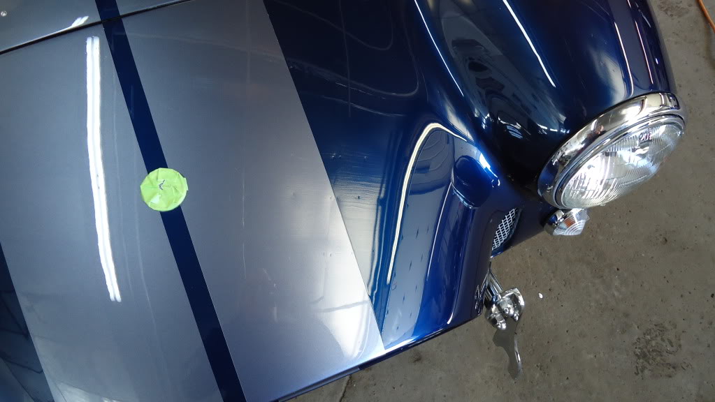

    Here are 2 photo's I just took of the car's hood and rear quarter panel.

  5. 911Fanatic
    Too dirty Bob. Please repost after a wash.

    That was the best I could get with the amount of salt on the car. I am hoping it will warm up today to above freezing so I can at least rinse it off or run it through the touchless. It is -10C here right now.

    Just ran it through the touchless and it is worse than I thought.
  8. 911Fanatic
    Looks like minor swirling Bob. I'd suggest Menzerna FG400 on a green or orange Buff and Shine or LC pad. It will leave a nice finish as well. You can follow up with Menz 85RD (SF4500) if you want to amp up the gloss a bit more.
