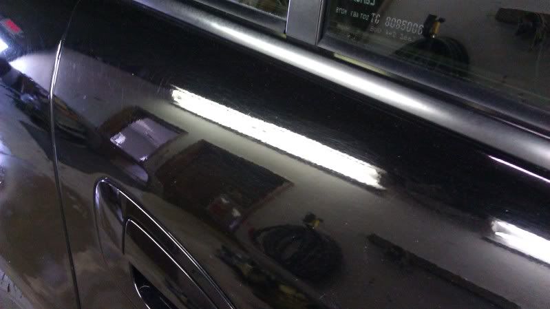

    Rear bumper has been repainted, and it is still scratched up.
    Overall, the car did not have very soft paint. It was quite hard, and I was hitting it with a very strong combo. Almost half the car has been repainted and that paint was very hard to correct. But overall a nice finish, matching orange peel, but deep rids.

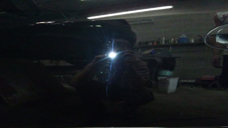

    After the wash
    Hard to see, but there are a ton of rids in the paint, some way too deep to get out.

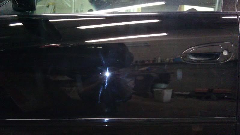

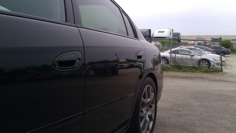

    After compounding i was left with this.
    As you can see the 3M compound was really tough and nice to work with, but left holograms everywhere

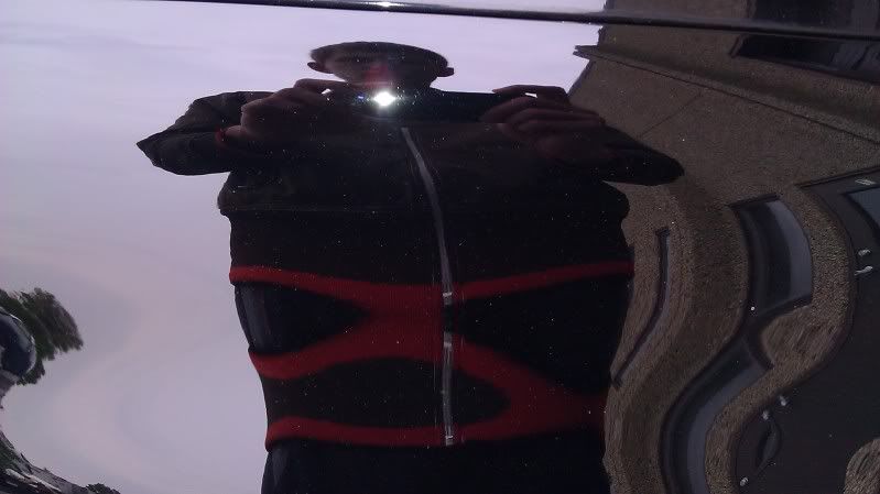

    Hitting it with Super finish and Uber green left a lot of holograms. So i switched to Uber blue and 205 and was left with this

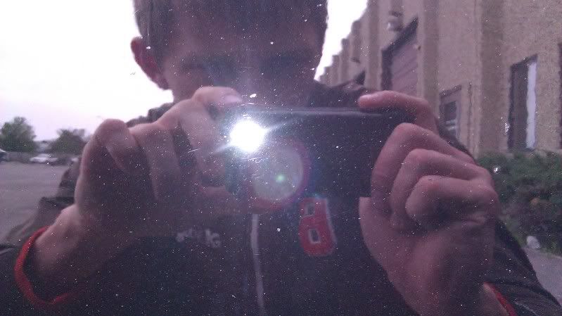

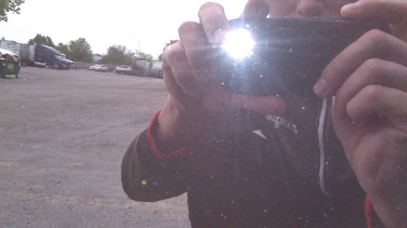

    Car got a layer of Colli 845 for this finish :) enjoy
    Overall I achieved a level finish, which is what I wanted out of all of this. I am happy with the results and now thinking of selling the car to get something different for the summer.
