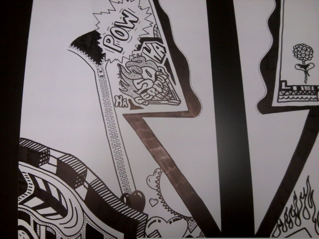

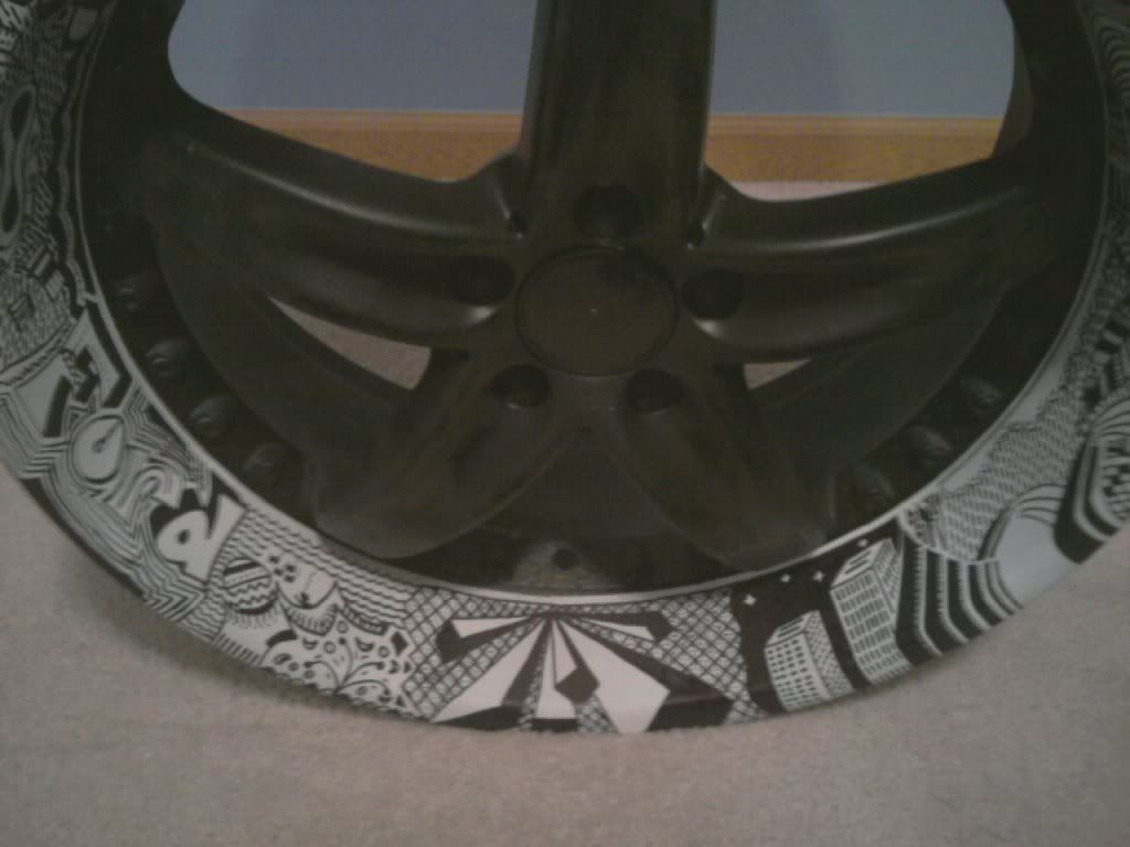

    There's a guy on ModdedMustangs.com who attempted to do it, but eventually gave up because he couldn't get it to lay down even enough for his taste. But luckily he just peeled it right off!
    Also a guy who used white plastidip on a black car to paint some stripes, wheels, and interior stripes. He's then putting graffiti on top of the plastidip with a sharpie. It looks pretty sweet and is definitely unique, I just question the durability of it for something he has put so much work into.
    Some pics:
