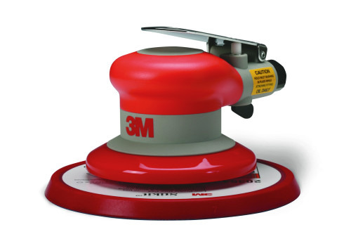

    3M AIR FINISHING SYSTEM. Brand New Random Orbital Sander. 12,000 rpm 3/32 Orbit $125.00
    Hey guy's found one of these on the internet.
    (A) will it work?
    (B) Is it worth it?
    Thanks,Seth

    Is it this one?
    Should be fine, looks like the air vantage/mirka.
  3. Buddy
    Hey Seth, Looks good. It'll work great. I agree with gmblack3 and his comment. What Is the CFM rating on It and will your compressor handle It. just a thought bro...:shrug:

    Hi Seth,
    Here are specs on Air File
    Yes, it will be fine for wet sanding.
    What will you be wet sanding?
    I also have a Very Fine Sanding System with Hundreds of Discs, See below.
    Model Number
    40320
    18" Long Belts
    Motor hp (W)
    .5 (373)
    Motor RPM
    20,000
    Sound Level
    80 dB (A)
    Abrasive Belt Size Inch (mm)
    1/4-3/4 (6-19) W x 18 (457) L
    Maximum Air Flow SCFM (LPM)
    28 (793)
    Isn't this to much for my comp?
    Max. SFPM (SMPM)
    4,550 (1,382)
    Air Inlet Thread
    1/4" NPT
    Weight Pound (kg)
    2.5 (1.1)
    Length Inch (mm)
    14-1/4 (362)
    Height Inch (mm)
    4-7/8 (124)
    Air Sander - BRAND NEW - $125
    Thanks for the reply's guy's
    my compressor's specs are 6.3 scfm @ 40psi/4.9scfm@90psi 160psi total. I don't think it will work.

    What size tank and how many horse power is your compressor. It does sound like It is to small...:shrug:
    You know that there is only one thing to do right...buy a bigger compressor...:thumb:

    1.6hp 26gal
    I just bought it this summer.
    I'd say i need a different sander:shrug:
  7. Buddy
    I have a big compressor and a small compressor. My small compressor is 2 HP 20 Gallon. Even the the average air tool being 4 to 5 CFM It still fights to keep up if you are doing a medium task. Some sanders have even higher CFM's like 8 to 10 which would kill our small compressors. In my humble opinion. This air sander or any other air sander is only going to cause you grief. I have already tried what you want to try. You now the ole saying about trying to get 10 pounds of poop in a 5 pound bag. Good luck Bro...
