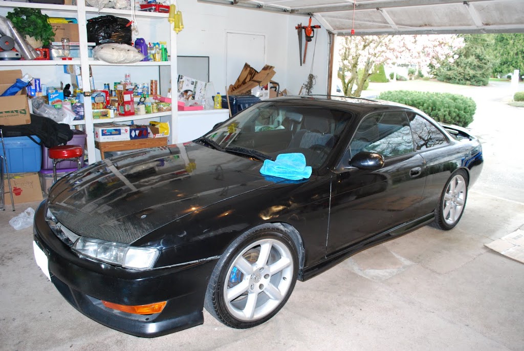

    Upon delivery I knew I had my work cut for me for 8hrs.
    Umm.....Crap:thud:

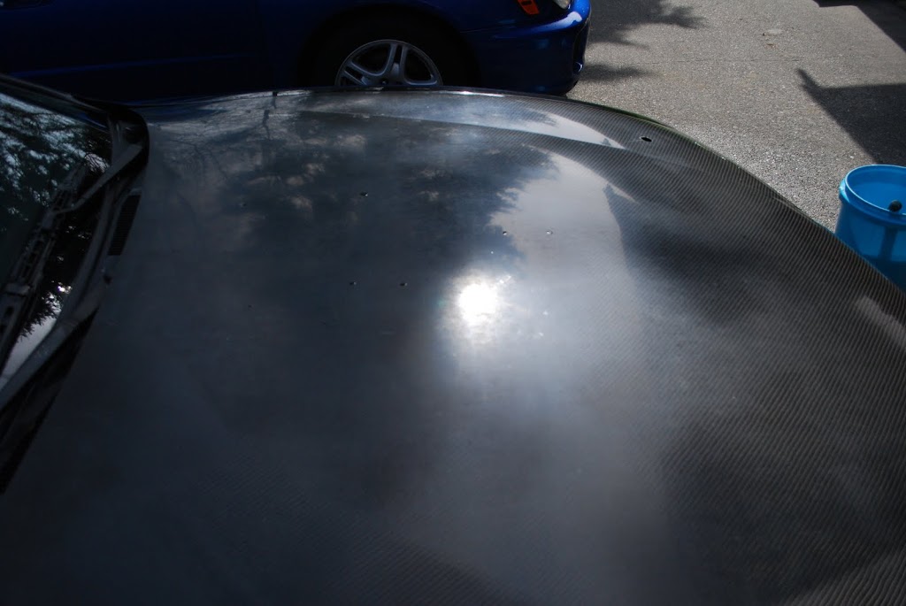

    Carbon Fiber hood is very faded and dull, not sure what I'll be able to do with this

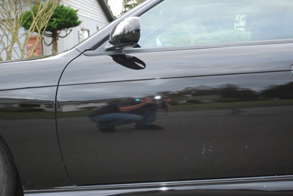

    Hm.. odd scuff
    Another scuff

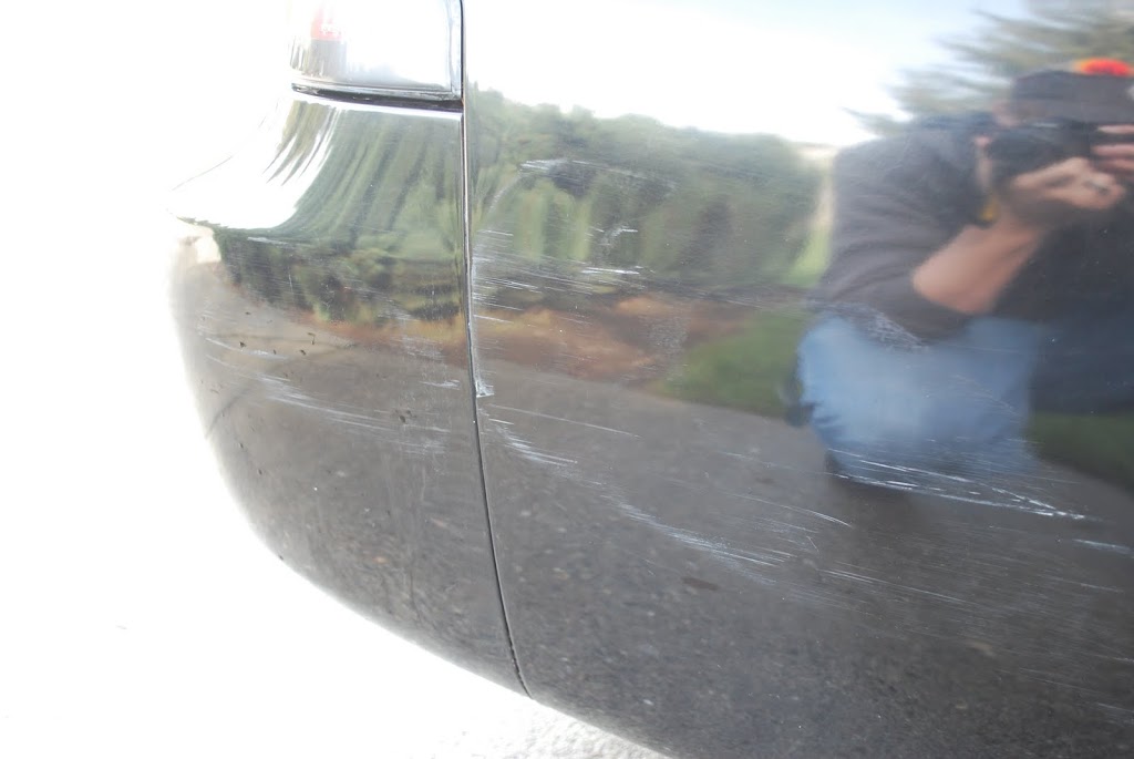

    Fairly deep scratches
