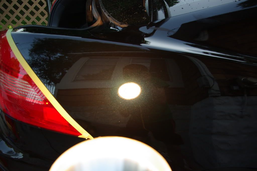

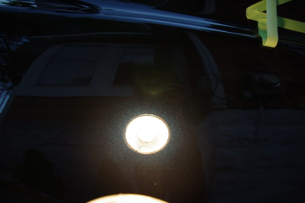

  11. Misha
    Misha Nuba Guru
    i did my honda with power gloss. it came out crap but i didnt know it till i tried 203 after that.
    this is after power gloss
    this is after i did it with 203, left side is after power gloss. right side after 203
    i do have g110 and use 4" pads for polishing. i like having more control then you get with 5.5 pads and gona be switching to flat pads when its time to replace pads
    only problmew ith g110 as with pc7424 is speed. i wouldnt mind trying flex or rotary for that matter
    had to use wool pad yesterday with power gloss. didnt had to wetsand this way

    ^^ That's pretty terrible dude. Get some flat pads. Sonus yellow and M105 on speed 6 is perfect for NHBP. I did 3 NHBP cars, 99% correction in one pass.
