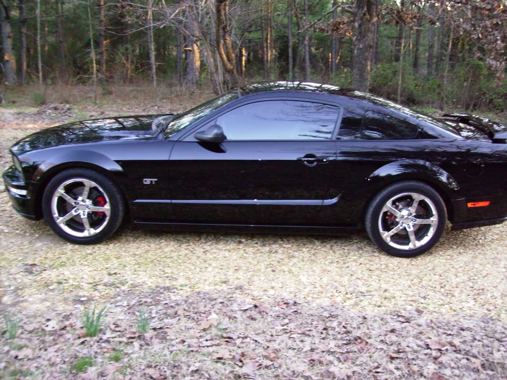

  5. Cooter
    Lusso Rejuvinating Creme, Vic Concours, and OID

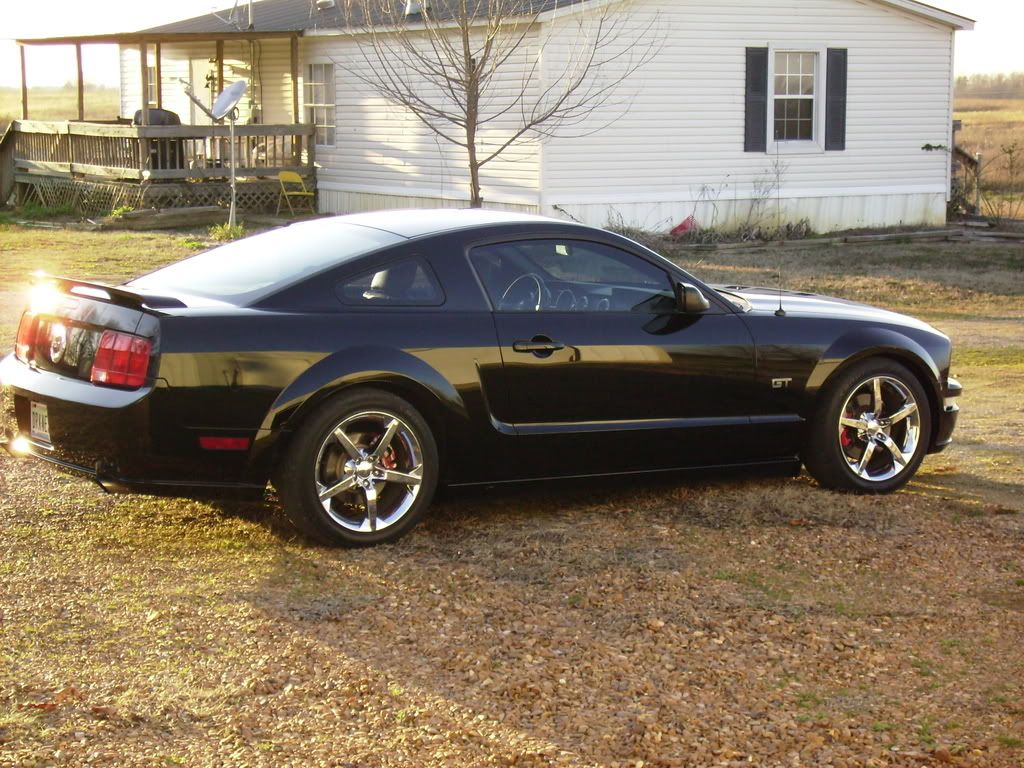

  8. jshillin
    jshillin Birth of a Detailer
    Looks great Heath!!!

    Since I do all LSP application inside, I use a halogen light to see where I've applied product. If the product is visible on the paint under the halogen light (even if it just appears as a "smear"), than it's enough product.
    Your car looks fantastic, BTW.
