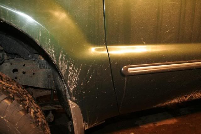

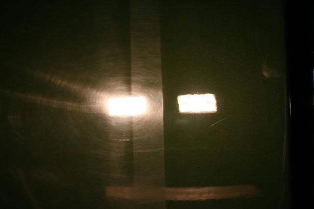

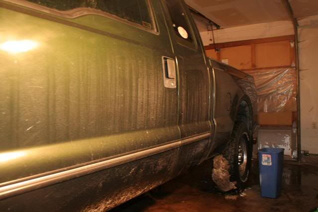

    I just went to visit my brother in law, who wanted me to take a look at his 2000 Ford F250 Super Duty. He thought he could shine up his truck on his own, so he grabbed a Makita, wool, and 3M heavy duty rubbing compound, and gave it a whirl. He wants me to "fix it", since now it's "dull". :eek:
    I need practice with my rotary, and welcome a challenge, so I agreed.
    This is what I'm up against:
    I went last night to wash, clay, and tape it off. I'm jumping right into this today, starting at 1:00 pm, and working through sunday.

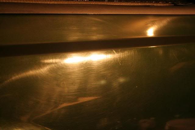

    Hmmm... think I figured out my process. 1Z Pasta Intensiv with a drop of Menz PG on green CCS gave me this:
    I'm still going to follow up with 1Z High Gloss polish, so this isn't refined yet.
    There are some deep RIDS that I won't be able to remove without wetsanding, and he really only wanted to bring the shine back. He is not going for full correction at all. He just wants it better than before, and is only paying for a one step polish. I think the results are okay so far.
