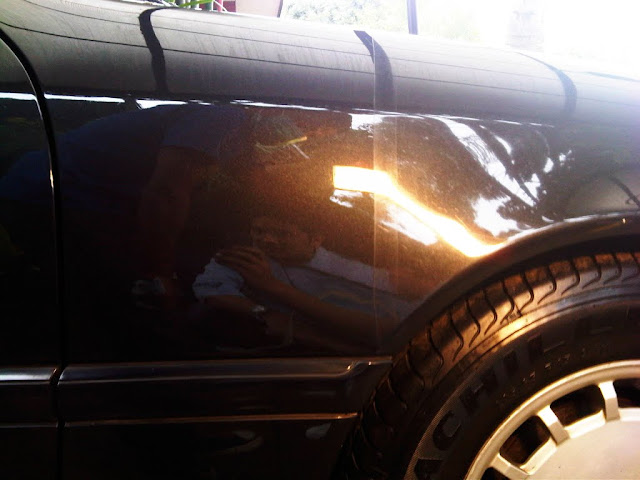

    this is one of my mate's car, a 1995 c 180, he's the second owner and this car has been with him for 3 years. it's his daily driver, has never seen any paint correction, hence its as close to a swirl heaven as a car can be. Paint was corrected using multiple passes of Scholl S17 on 3M wool pad, then another several passes of S17 on 3M perfect it polishing pad , the paint was refined with S40 on LC CCS grey pad (twice). LSp was 2 coats of 845 applied back to back. The next morning we came back to the car to apply 2 coats of OCW (i find this product to be really good, it adds warmth to the hard candy gloss of the 845, after a number of coats the car looked like it has a layer of oil on top of the paint cos it's so glossy. with its ease of application, OCW is a real value adder for me).
    50-50 shot of the front fenders, left side is corrected with S17 on wool and foam polishing pads the refined with s40 on grey LC pads

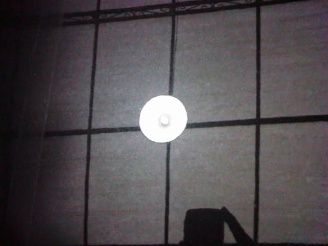

    the before side of the hood

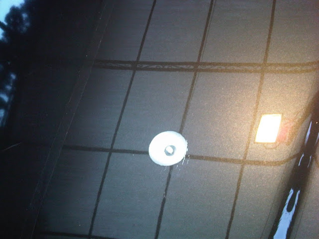

    the after side of the hood

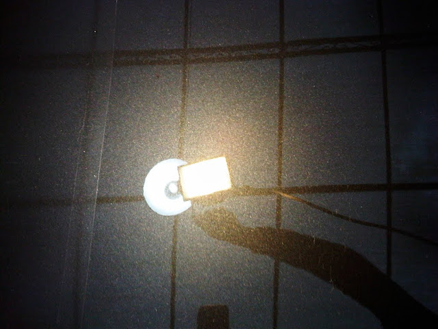

    the ceiling light revealed an area of the hood where the cc had some kinda cracks, probably due to heat coz this car has no heat absorbing layer under the hood

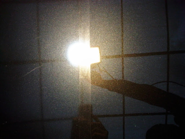

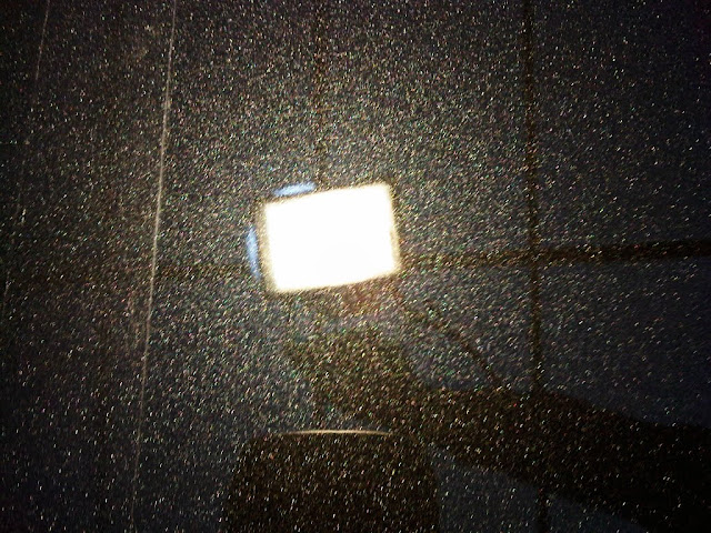

    lovin the flakes
    another 50-50
