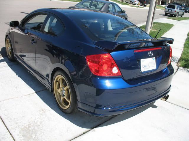

    I keep forgetting to post this detail up :doh:
    I did this over spring break. Me and my friend wanted to have a little detail day and I wanted to teach him for a bit how to use a DA polisher.
    Here's what we used:
    Meguiar's gold class shampoo (wheels and body)
    Shmitt and sheepskin
    Wheel shmitt
    Meguiar's aggressive clay
    Meguiar's UQD as lube (I diluted this 50/50, worked well, smells TOO damn strong)
    UDM with orange pad/XMT3, then white pad/106FF (just on one spot on the hood)
    Cleaned paint with Wolfgang Paintwork Polish Enhancer, UDM, and white low pro pad
    Pinnacle Signature Series II
    No befores, didn't have time :whistle:
    Here's the after results though, after a few days and after a wash:

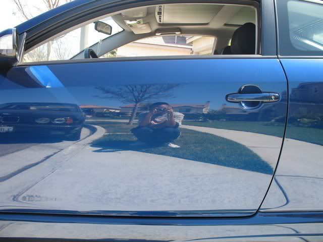

    We tried to remove the swirls on this spot as much as we can with the time we had :eek: I wish I had more time to stay

    Vehicle looks nice shame about the last picture as it looks like some micro marring is left on it but still I bet it's better then it used to be...oh and it's blue :druling: nice

    Nica - Thanks a lot :D. He put a chin spoier on it. Yeah, darn micromarring haha I wish I had time to remove it. Believe me though, his car is swirled pretty bad. I love the blue color too :druling:
