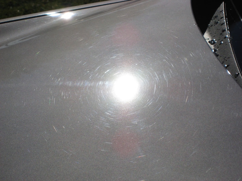

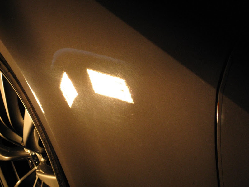

    After claying the car, I performed an IPA wipe down to see the true condition of the paint. I was shocked to see the amount of swirls the paint had!!! It didn't have that much swirls when I first inspected the car. The dealer did a really good job on hiding the swirls the car had.
    Before:
    The above 2 pictures are the swirls in the hood. The hood was in much better shape than the rest of the car as seen below: Sorry the swirl pictures didn't come out as I hoped. It was very hard to capture the swirls given the car's color.
    I think the picture above was ridiculous! It looked like the car originally had fuel stains below the gas filler door and someone tried to sand it down without even polishing it! I was shocked to say the least.
    Because of the paint's condition, I decided to go ahead and use a 2 step detail right off the bat. I used both Meg's M105 and M205 throughout my paint correction phase. Here are some 50/50 shots:

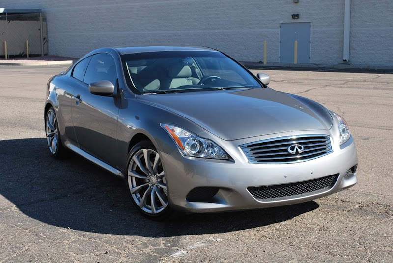

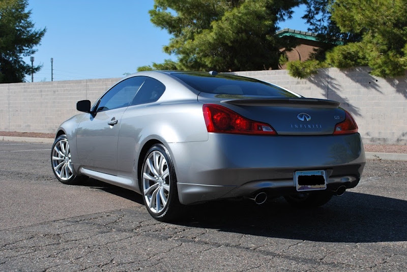

    After applying Menzerna Powerlock left to cure overnight and applying a coat of Autoglym Hi-Def Carnauba Wax the next morning. I couldn't believe how wet and slick the paint looked after. You be the judge...
    Photoshoot:
    Approximate time: 15-16 Hours. I don't know why it took this long...
    What do you guys think? Opinions, comments and criticisms are welcome!
