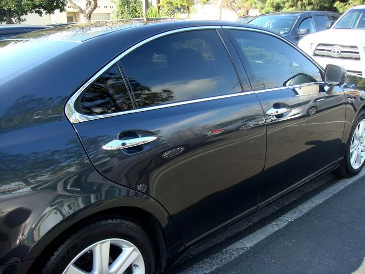

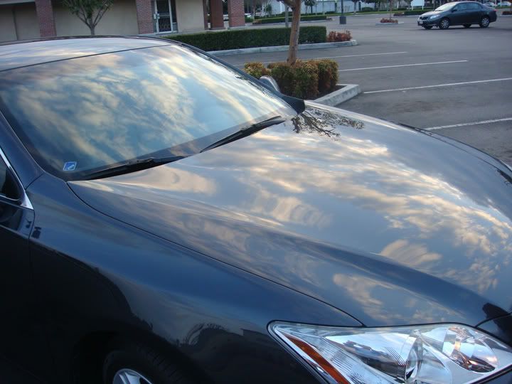

    Just tried this combo on my car this weekend and absolutely loved it. It leaves a very deep, warm finish that is very slick to the touch. I was wondering if anyone has tried the Blackfire Deep Gloss Spray with Polycharger and how you might compare it to Pinnacle Crystal Mist.
    Edit:
    Prep work:\
    -Car was washed with CG CWG Shampoo to strip off LSP.
    -Clayed
    -Polished with Flex 3401, Menzerna Power Finish with white pad, Menzerna Micro Polish with gray pad (Menzerna Top Inspection was used to remove polish)
    -2 layers of Blackfire Wet Diamond 8 hours apart, followed by 1 layer of Blackfire Midnight Sun Ivory Carnauba Paste Wax. Another layer of the wax was added one week later.
    -Final wipe down with FK 425.
    -Tires dressed with Z16 and wheels sealed with Opti-Seal.

  16. detaildoc
    detaildoc Guest
    Yes, I did two coats of the sealant 8 hours apart and then one coat of the nuba 8 hours later. Unfortunately I did not get a chance to take pics because it started to drizzle before the wax fully cured and before I got a chance to take pics. I'll try to take some this weekend if not does not rain. I might add another layer of the nuba as well.
    Both the sealant and the nuba make the metallic flakes pop. Another nuba that really makes the flakes pop is P21s100%. I have yet to find a nuba that makes metallics pop like P21s100%.
    Here's a review Blackfire: http://www.autopia.org/forum/car-detailing-product-discussion/112792-no-love-blackfire-wax.html
  17. detaildoc
    detaildoc Guest
    Pics added on original post.
  18. SSTG
    SSTG DB Forum Supporter
    Nice car Doc. Good job.
  19. 911Fanatic
    Those pics look sweet. Very nice finish on that!
