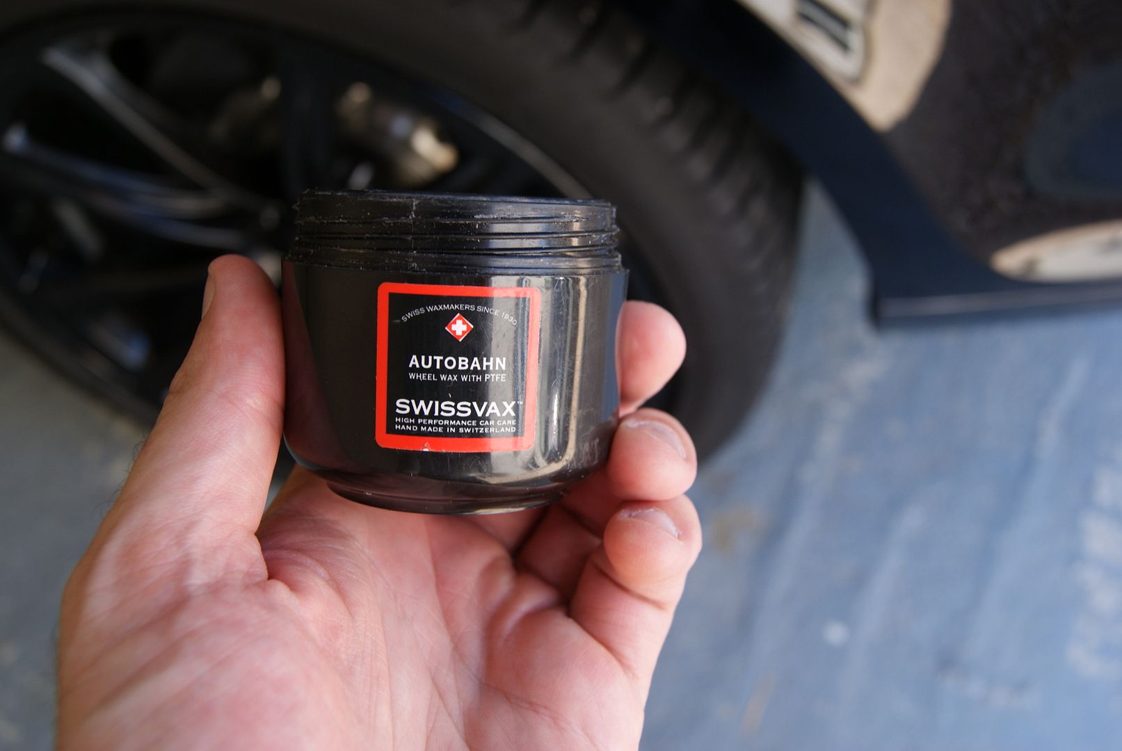

    once the correction was completed, then applied Swissvax Cleaner Fluid to paintwork and alloys, then buffed off then on the paint work applied Swissvax Crystal Rock and Autobahn to the alloys and Pneu to the tyres:
    At this point i finished for the day leaving the Crystal rock to cure over night.

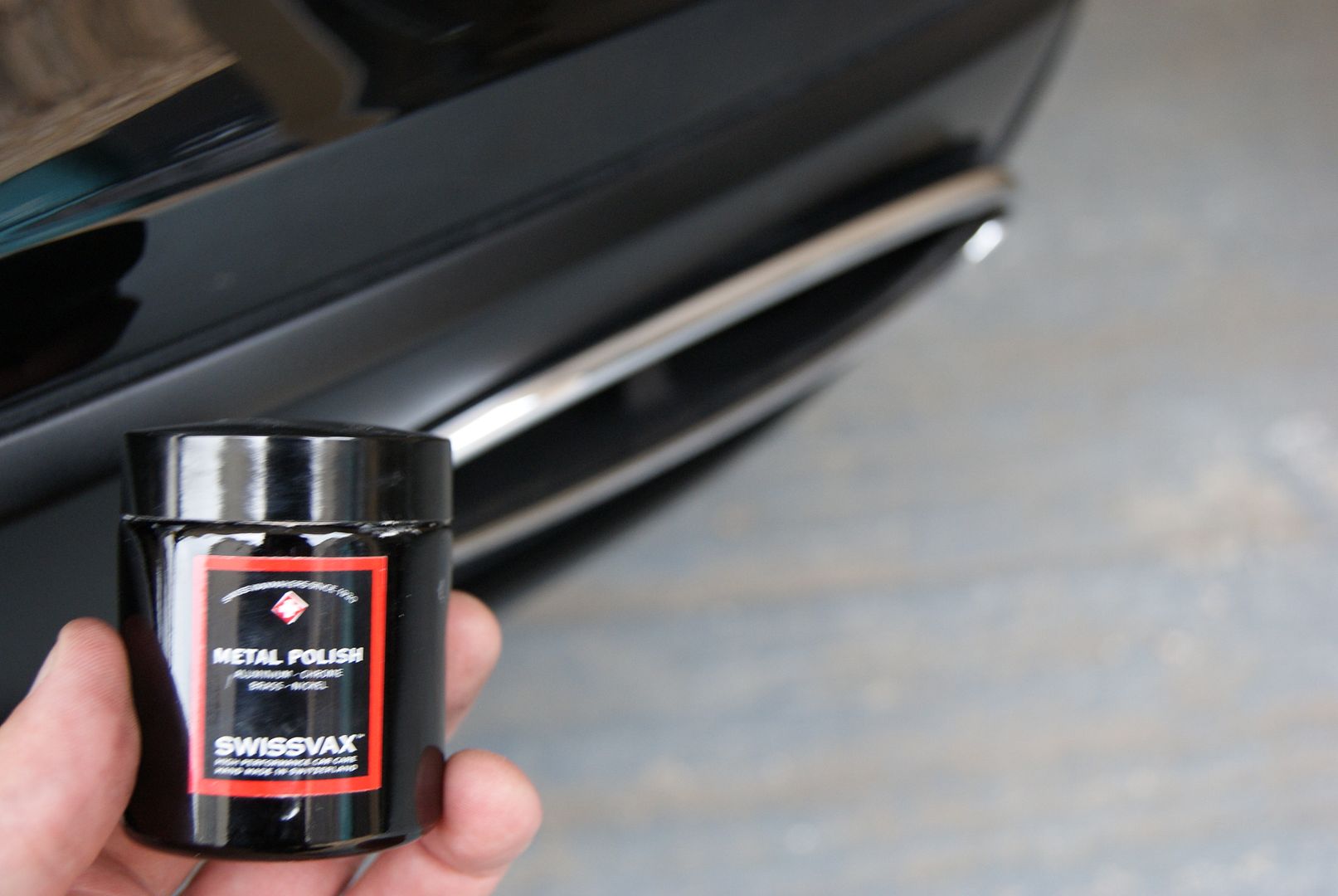

    Back the next morning, and removed the cured Crystal Rock and Autobahn, left to air for 15 mins then applied the second coat of Crystal Rock to the paint work and left again. whilst curing I cleaned the exhaust tail pipes with Swissvax Metal Polish and ultrafine steel wool:
