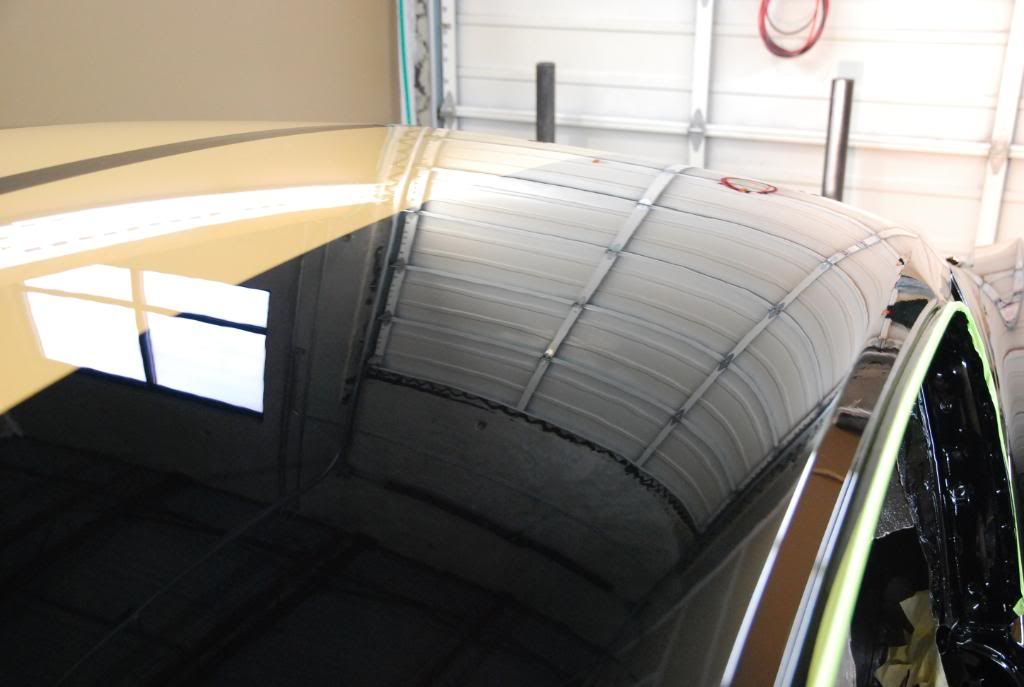

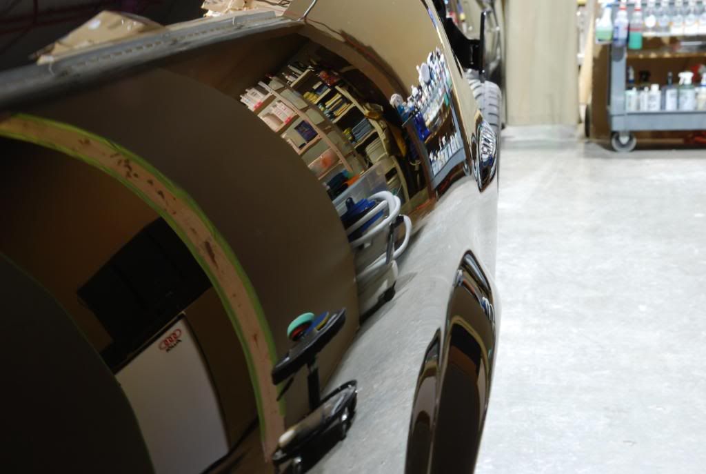

    Almost finished the body today. Doors were dropped off with hood and trunklid coming Thursday.
    There was soooo much orange peel on this panel.
    The result
    Passenger side before final polishing
    Roof complete - no LSP yet. The walls in my shop are 24' tall.

  5. Reflect
    Reflect DB Forum Supporter
    Looks awesome Ken. Wet sanding definitely makes the difference. Looks perfect from the pictures. Any plans for the wheels? I really need to learn how to polish wheels and whatnot, I feel like the few times that I've tried I've messed it up.

  13. mrgolfrider
    Was the clear applied extra thick in preperation of you wet sanding? How much did you take off from when you got it in the shop? The finish on that is about the best I have seen in a while!

  15. supercharged
    amazing work, Ken! Seriously, I love those reflection shots!!!

  18. 911Fanatic
    I believe four coats of clear were applied with it being sanded out between coats. The last two coats were applied heavy. Readings on the car were all over the place so had to be careful. One 1/4 window panel had readings between 230 and 320 with one area reading 170. Yikes! We took one area down 125 microns chasing a large piece of dirt. That area still has 280 microns left. Not adviseable to take off that much but the owner said to make it perfect. Amount removed depends on wether it was sanded with 2000 or 1500 and 2000. 1500 removes a lot more clear in a hurry. Pus I'm polishing with wool and UK Menz Powergloss which cuts like crazy.
